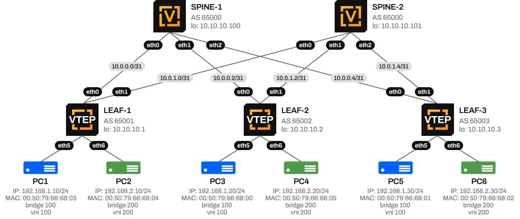

The Distributed Gateway Scenario
The following scenario illustrates a typical EVPN-VXLAN deployment in a Leaf–Spine topology. In this For example, PC1 needs to communicate with PC6. Because the two hosts belong to different Layer 2 segments, VLAN 100 for PC1 and VLAN 200 for PC6, the traffic must be routed through the default gateway. Therefore, PC1 first needs to learn the MAC address associated with its gateway IP address (192.168.1.1). One of the key advantages of EVPN is seamless host mobility. If PC1 moves from a location connected to LEAF-1 to a location connected to LEAF-2, it can retain the same IP address and default gateway configuration. Additionally, PC1 does not need to relearn a new default gateway MAC address, as the gateway is presented consistently across the fabric.
In this topology, PC1 and PC3 are connected to LEAF-1 and LEAF-2, respectively, while remaining in the same VLAN. They are used to represent the movement of PC1 between leaf switches. PC6 is connected to LEAF-3 and resides in VLAN 200.
anycast_diagram
